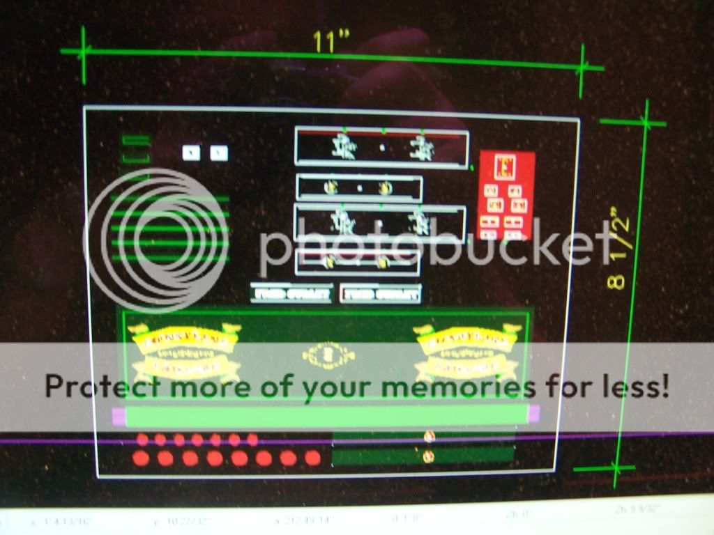

To start with, I am not a graphic artist and not familiar with the programs that should be used to create this art. Programs such as Corel Draw or Adobe Illustrator would be the ones that most people would use. I am familiar with CADD and so that is what I will show here. The approach would be similar no matter what you use.
I start with a scan of the locomotive from Steve’s book. This I enlarge to the size that I wish to model. This is a relative process. I have used the height of the cab as my reference in the past setting the height of the cab in the scanned image to the height of the model that I am kit bashing. This way the engine will look proportionate to the rolling stock. You could use the size of the drivers or any element of the original model that you wish to keep.
Next I import a photographic image that will be used as a basis for the artwork. The image is enlarged to the point that it would fit on the scanned image of the engine. If the photograph was taken straight on and there is not much “warping” of the image, it might be possible to trace as is. Often some correction has to be made to keep lines straight and arcs symmetrical. Now starts the laborious job of tracing the image line by line and arc by arc to create the artwork. Since all of the Disney fonts are custom, lettering is also traced as lines and arcs. If I can find a close font, I will use it.
I draw each color in a separate layer so that I can adjust them more easily and so that I can turn off the background color if I need to.
When the artwork is printable, always print it out and test it for size and color directly on your model. It is no fun to create great looking art that turns out not to fit properly on the model.
